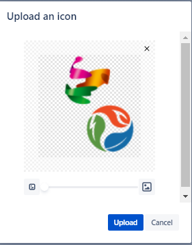

My project  logo shows as it should in Edge in Jira Service Desk, in Chrome the lower part is being cut-off even though when when adding the logo through Chrome the logo fits within the editor frame.
Please see attached print screens for details.
Appreciate any input to correct this issue.
Regards
Rune
From Chrome: Logo fit within the frame in the upload editor:
From Chrome: Logo being cut-off
From Chrome: Logo in Service Desk view
From Edge: Logo in Service Desk view

I understand that you are uploading a project logo for a Jira Service Desk project, but that this logo looks like it is getting clipped incorrectly when displayed in Chrome.  I am interested to try to learn more here so that we can try to help here.
  • What version of Chrome are you using here?
  • Whats the source dimensions of the image you are uploading here (before any adjustments made by Jira)?
  • I see this image has transparencies, but this is a .gif or a .png or some other format?
I'd like to be able to recreate this behavior in order to better understand it myself, but so far I have not been able to do this.  At least with my own Chrome running 83.0.4103.116 (Official Build) (64-bit) and the few sample images I tested with appear correctly in my version.  So I'd like to learn more here to try to recreate the problem you have reported here.

I'm on the same Chrome version as you. And the file is a png.
I've manage to fix the problem. Initially the file was 187kb and dimension 61x71 pix (transparent).
I swapped to a file non transparent and with file size 13kb and dimension 116x107 pix and that seems to do the trick.
I've tried to search for size limitation for custom logos/avatar picture etc but haven't found any hit yet (most likely due to that I'm not that familiar with how to navigate in the jungle of help files in Atlassian yet... ). Is there some articles/guides in file size and dimension?
