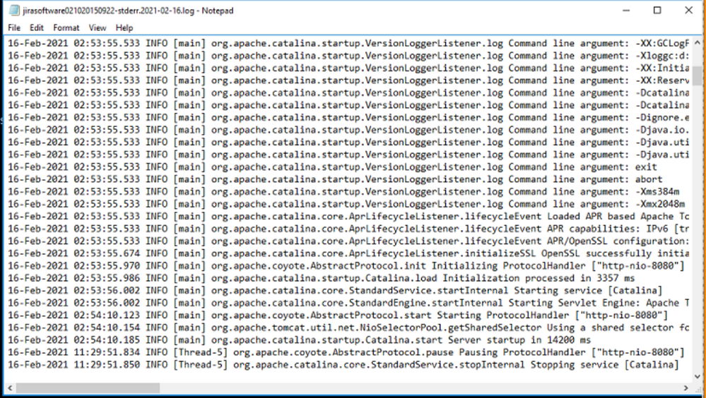

HI Dirk, it looks like per the logs, I was able to find out that the Startup check failed and I believe it locks our Jira Service and then begins to fail to load until we manually restart it again. If you see below in the pics, you can see when we have our servers auto restart at 2:53am it fails but then we manually restarted them at 11:29AM today - any idea on how to fix this approach as to why it locks out?

Well yes and no, it actually locks your JIRA because the startup check failed.
Do you maybe have more details higher in the log file?
I wonder if you restart the server, do you shutdown JIRA cleanly first or just kill the machine dragging JIRA down with it. (So maybe it wasn’t closed cleanly and now fails because of it) If you could get the log from just before the restart up to that error I hope something is in there.
If not, opening a ticket with Atlassian might be a good call (with the support.zip) so the engineer can dive deeper in the logs.

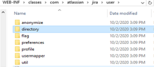

ORT JIRA ADMIN February 16, 2021
Here is a few more screenshots, I hope they help? How can I open a ticket with Atlassian Engineer?
I believe we just kill the machine dragging Jira with it since we run an automatic task scheduler at a time frame early in the AM.

The new screenshot only confirm that something is breaking at startup causing the service to abort.
Without full access to the log(s) it's tricky to troubleshoot so I'll have to forward you to Atlassian.
