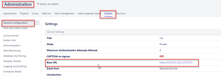

Replace the url with your JIRA base URL:
https://asc.mycompany.net/jira
You can verify and retrieve the JIRA Base URL from Administration --> System --> General Configurations --> Base URL
