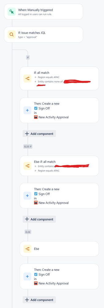

I have an automation that is trying to create different subtasks on an issue depending on the values of 2 custom fields: Region & Entity.

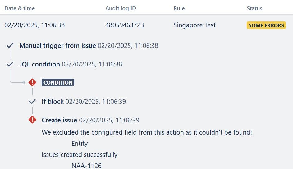

I keep getting an error in the audit log that says the field "Entity" has been excluded from my if/else block as it couldn't be found.
I tried forming the if/else conditions using JQL with "Entity"'s custom field ID, but I got the same error message.

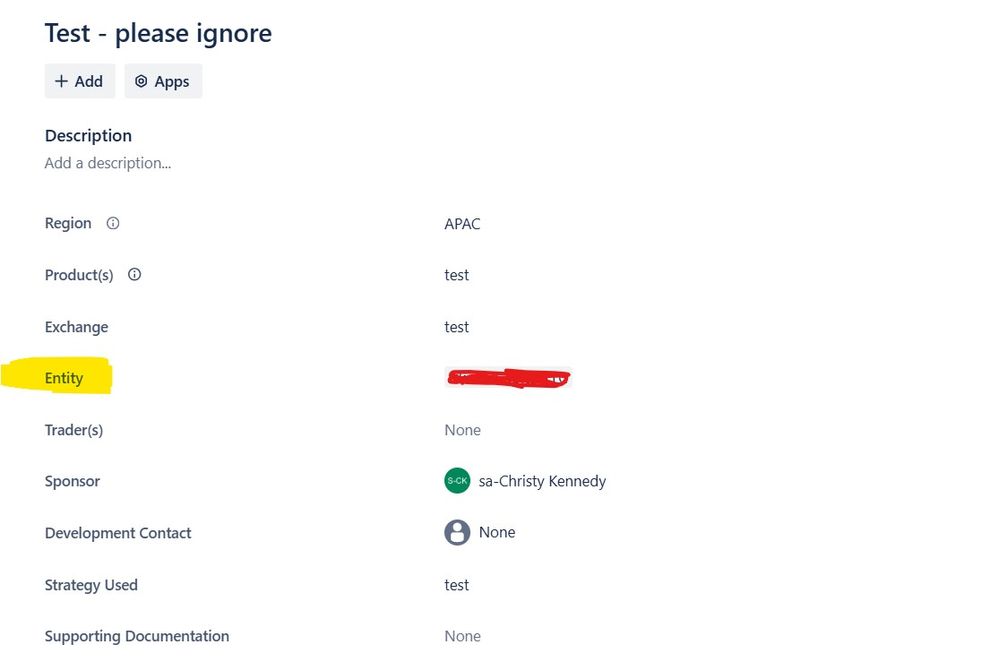

So, if you click on the Create button, and you put in that project and the Approval issue type, you see the Entity field on that screen?
Christy Kennedy
February 20, 2025
Correct - it is even a required field

Ah! So maybe there is not a value for that field. Can you share the details of how you are populating that field in the rule?
Christy Kennedy
February 20, 2025
Aha! I did not realize that the error message meant 'Entity' was not being populated in the subtask the automation is created, I thought it was not being analyzed as part of my if/else conditions.
The problem is actually that it isn't copying the value of 'Entity' from the parent ticket:Entity create new issue.jpg

How I fixed for reference:
The circled 'Entity' field above is actually an old custom field with the same name that has been deleted. I needed to remove it from "Choose fields to set", then add the correct "Entity" field that is included in my issue type's screens

Christy Kennedy
February 20, 2025
Update on using a Smart Value with the custom ID field:
Still receiving the same error:
Updated rule logic:
