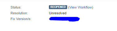

Amrita Nair May 25, 2018 edited
@Jack Brickey
1. I can see 2 issues
2. Status : Reopened (screenshot)
Capture4.PNG 2. In the column list,  Is this how you meant to add a column? If yes, what status should I map here?Please advise.
Capture5.PNG 3 & 4. In view mode i can see the fix version, however it is not editable. Tried editing using the edit option as well. The field does not appear in the edit mode.
Thank you for the suggestions. :)
Jack Brickey
May 25, 2018
Amrita, ok so you are getting off track a bit. First remove the column "Fix Version" in your board. You don't want that. What I was trying to convey was simply to display the Fix version field in the columns on the Search issues view not the board view. But you have shown
if you cannot edit the fix version then it may be that you do not have resolve issue permissions. please check on this. project > Settings > Permissions and check Resolve Issues to ensure you fall into one of the groups allowed to do this. BTW, I assume you have system and or project administration permissions? I see you are redacting the Fix Versions in your screen shot and not sure why. I assume these are simply numbers like 1.4, 1.5, etc.
One other thing, in looking at your column config under the To Do column it shows that there are 2 issues in the reopened status. Are you absolutely sure they don't show? The fact that you have 150 issues in To Do is a bit overwhelming and would be a challenge to find anything in a list that big. I recommend creating a quick filter in the board - status = reopened so that all but the reopened are hidden when that QF is selected.
Ultimately I think what you are going to want to do is to add a post function to the 'reopen' transition on any all workflows. In that post function you are going to want to  clear the fix version field. I was just trying to have you manually do this on one of the reopened issues to see if the issue then displays. However, if you want you can simply go straight to the post function and give it a try. Note that this will NOT address those already in the Reopened status obviously so you need to be able to edit FV manually so work toward that.
