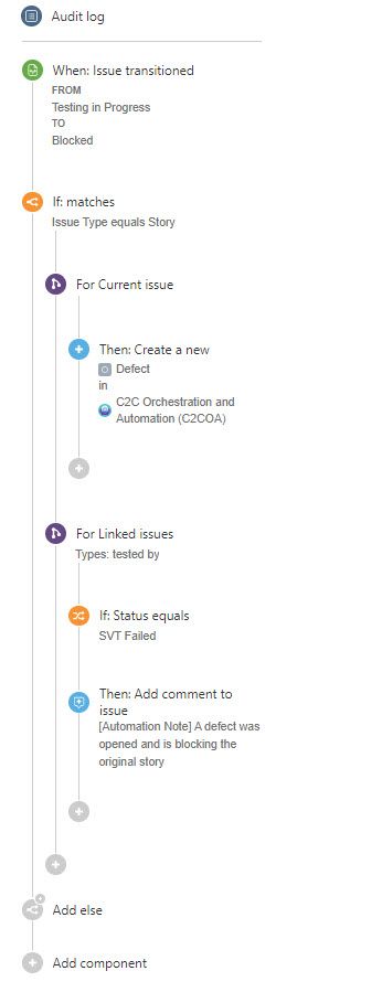

Thank you for that but it is contained with a single 'if' rule. Here is the whole view:
April 18, 2023 edited
I do not believe you need the For Current Issue branch as it is just nesting down from the trigger issue.  Instead you can just reference {{issue}} or {{triggerIssue}} as needed.
Please try removing that branch to see if the {{createdIssue}} smart value becomes more visible to the branch below it.
Like • Rafa likes this
Rai Warbasse April 18, 2023
Bill, you are a savior. That was the issue. removing the initial branch fixed it.
