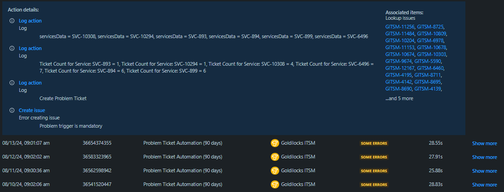

Please help me investigate my automation i dont know how to fix this error JIra automation.png Error 1.png error .png

Hello @RAMCEL MAGNAYE
The error message in the Automation rule log is indicating that the Problem Trigger field does not have a value but is a required field.

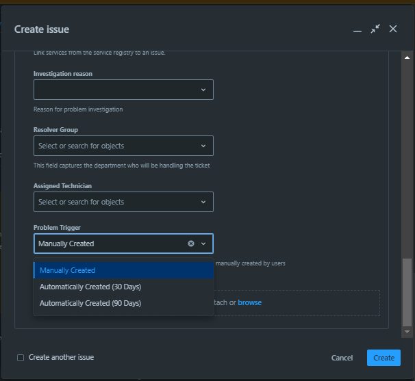

Looking at the images you provided, the value that you have specified for that field in the Create Issue action:
...doesn't match the values that are actually available for the field in the Create Issue dialog.
Notice in the Create Issue dialog the value has parentheses and in your rule it does not.
That suggest there may be more than one field named "Problem Trigger" in your instance with slightly different options, and in your rule you have chosen one that is not the one actually used in the issue type you are trying to create.
In the Automation Rule when you used the "Choose fields" pull down to select that field, did you see more than one field with that name?
Are you working with issues in Team Managed projects or Company Managed projects?
You may need to used Advanced Editing with JSON in the Create Issue action to edit the field, using its custom field ID to identify it instead of its name.
You can find information on how to edit/set a field in that manner in this document.
https://support.atlassian.com/cloud-automation/docs/advanced-field-editing-using-json/
And you can find information about how to determine the custom field ID in this document:
https://support.atlassian.com/cloud-automation/docs/find-the-smart-value-for-a-field/
If you have more questions about that, please let us know.
RAMCEL MAGNAYE
August 13, 2024
thanks @Trudy Claspill will check this if the issue presist i will let you know thanks
