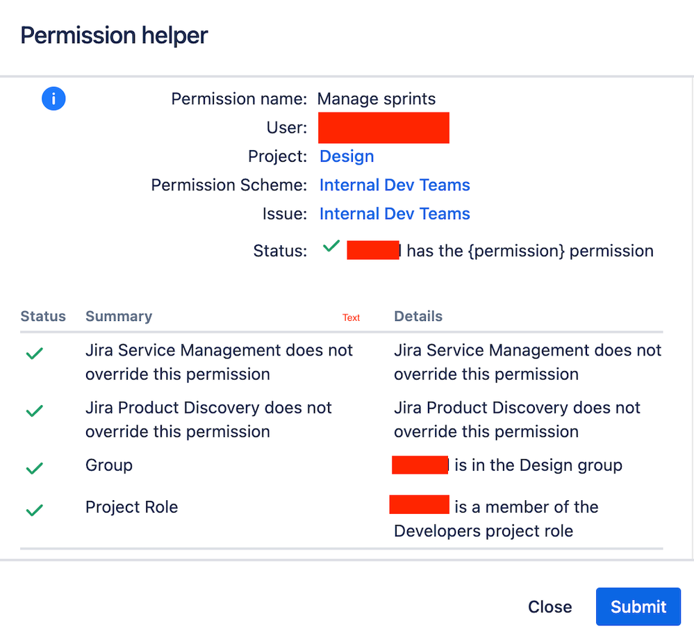

On the Permissions screen for the project, click the "Permission Helper" link in the upper right corner of the screen. It should bring up a window where you can enter a user, a Jira issue number, and then select "Manage sprint" for the feature. It will tell you why or why not that person can perform the action.

Shannon Smith July 9, 2024
I checked all that. But this only checks for "Manage sprints" permission, which they do have. That's why I think something is overriding the "Manage sprints" permission when people try to create a new sprint. (It's weird because they can still start, end, and edit a sprint.)
