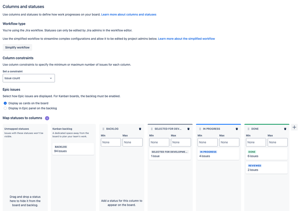

As @Stephen_Lugton mentioned the details of your board's filter would be helpful, as well as a screen image of the mapping of Statuses to Board Columns for your board configuration. That would be similar to this:

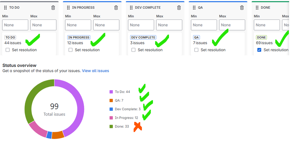

The Kanban columns are now showing the correct number of issues. However, I’ve encountered a new issue where the "Status Overview" is displaying an incorrect count for column "Done". You can easily spot this by the reduced number of total issues (compared to the previous screenshot I shared), even though I have added more items to the board!
I don’t think this is related to filters, as I’ve already tried clearing them.
Hello @Mary
If you click on any of the Status shown in that donut chart it will take you to a list of issues.
If you examine the URL I think you will see that a timeframe filter is being applied. In my system I see this at the end of the URL
+AND+statusCategoryChangedDate+>%3D+-2w
Converting that to plain JQL =
AND statusCategoryChangedDate >= -2w
This appears to be applied to any status in your board that is in the "Done" Status Category, and it does not appear to be configurable.
Thanks for the quick response! Yes, I can see that in the URL.
Just to confirm: does this mean the time frame filter cannot be removed?
I couldn't find a method to change the chart on the Summary page to remove the timeframe component. I believe there are change requests open about being able to customize the page.
You could create a separate donut chart on a Jira Dashboard where that timeframe component would not automatically be added.
Thanks @Trudy Claspill
I was using the built-in feature as it seemed to be the easy option! I might need to explore creating the chart separately on a Jira Dashboard if that’s the only way to avoid the timeframe component.
That is the only way to avoid the timeframe component since it is not possible to modify the Summary page at this time.

It would also help if you could share the filter that your board uses; you can find this from the Configure Board option accessed from the ellipses (three dots ...) at the top right of the board and selecting the general page from the available choices.
It would also be helpful if you could provide a screenshot of your column setup so we can see what we can do to help with the Dev Complete column
