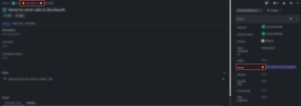

If you have verified that Initiatives are showing at the top of your Work type hierarchy, the next step would be to use the 'Parent' field to create the parent-to-child relationship between Initiatives and Epics.  The link you described does just that, create a link, but doesn't create a hierarchical relationship.  Make sure the Parent field is present on your Epic screen(s).  Hope that makes sense!

This was it!  Thanks!

i figured it out.  I needed to add the initiative in the Parent field, even though I already related initiatives and epics using the 'has Initiative' issue link.
