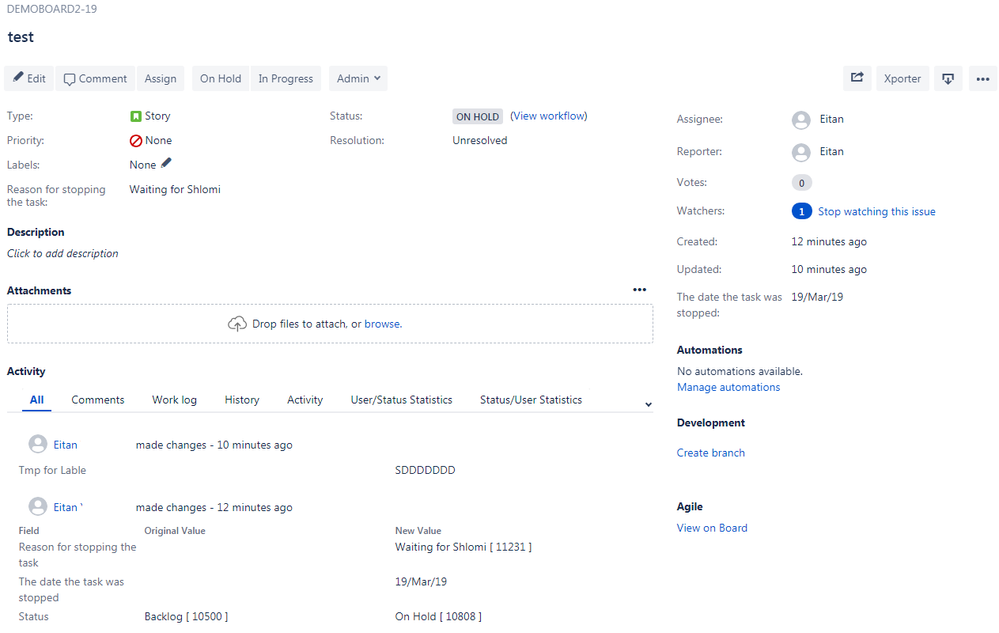

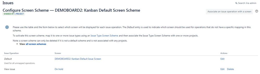

I've done the first three steps you specified, but because I set this screen to View, it "overrides" me the rest of the fields.
Attached is a picture of the screen (on hold) in the setting and a picture of the issue.

If you edit the issue and they show with values but don't show in the issue details I'm don't to know why, I've never had that happen.
