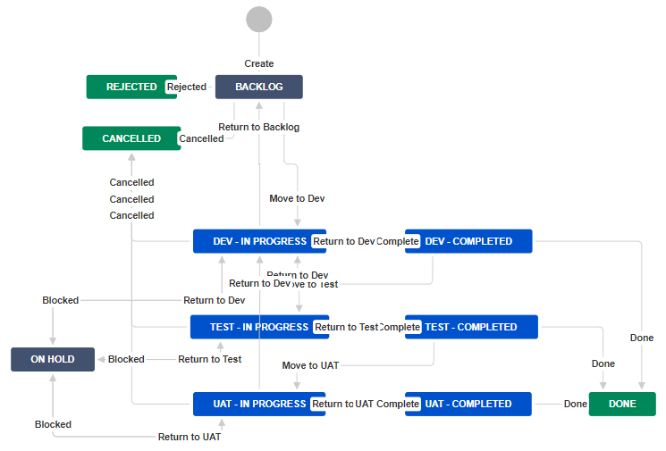

I'm using Atlassian Jira Project Management Software (v8.3.4#803005), Project Type = Software, using a JIRA server (please no Cloud answers, thank you).  We set up a simple workflow for software development that mimics the SDLC and are using it with the JIRA Kanban board.  The workflow was set up using "Software Simplified Workflow Scheme" and "Kanban Issue Type Scheme" which is what we have access to.
General Steps to create tasks for our Kanban Board:
  1. Create an issue using the 'Create' button (to create new issues) in the blue bar at the top of the screen - issues start in 'Backlog'.
  2. Move issue through the different stages (or columns on Kanban board) starting with 'Dev - In Progress' until it gets to 'Done'.
Once we get to 'Done', our issue stays 'open' because we can't figure out how to set 'Resolution' to either 'Resolved' or 'Fixed' and/or somehow get it off our "Open Issues" list.
After wracking my brain and reading lots (and lots!) of posts and Atlassian Help Pages, I'm beginning to wonder if our workflow is incorrect.  I've seen workflows with 'Open' and 'Closed' and workflows without.  At this point, we just want to get fixed/done issues off of the Open Issues list.  It's confusing for folks watching our project to see issues that were taken care of, sometimes months ago, still appearing in our 'Open Issues' list.  We don't have access to JIRA Admin or backend things like Add Post functions or anything like that.
2 questions:
  1. Is our workflow correct?
  2. Can you suggest what we can do to get closed/done/resolved issues off the 'Open Issues' list?
I've attached screenshots of our Issue Details, a test I did with adding a status 'Resolved' (which loops back to 'Done') and our workflow.
Many thanks for your assistance,
Fran
jira forum - issue details.pngjira forum - test with resolved.pngjira forum - workflow.png

My guess is youi are using "Extended project administration" permissons which is why he could make limited edits to the workflow but not add post functions.
Yes, your workflow is currently broken. Generally you have to set resulotion when transition an issue to "done" This is usually done in 1 of 2 ways
1: A transition screen in the last transition that allows the user to set the field
2: A post function that sets the resolution to a static valule.
MY guess is you copied the workflow and them removed the transition screen, thinking you were making this easier, but not.
As to how to fix it. This gets a little tricky. Not much you can do without a full jira admins help.
  1. Adding resolution to the edit screen. This is generally a bad idea unless you take other steps. Resolution is a required field in the field connfiguration. Meaning if it appears on the screen it has to be filled in. If you put it on the edit screen, and someone edits a ticket that isnt closed, then they will have to set a resolution, which you dont want. So to be safe you need to first make the field optional, then add it to the edit screen. However You would need full jira admin rights.
     If you know no one will be working, you can try to add it to the edit screen, change all the tickets, and then remove it from the screen, Have to be careful that no one else is using jira
    So in general, I would not recommend this option.
  2. You need to fix the workflow anyway. So talk to your jira admin. Ask them the add a post function to set the resolution on any of the transitions that lead to done. While they are at it, ask them to add a transition that goes from done to done called "fix resolution" with a post function that sets the resolution, (and a validator that the resolution is empty if you want) You can then run that transition on any broken issue to fix it.
In short, talk to your jira admins, you will need thier help to fix it.
France T March 19, 2020
Thank you very much for your reply!
I was hoping to get this accomplished without JIRA Admin help but it sounds like a solution has to involve them.  Also, thank you for including what I need to email to the JIRA Admins because I couldn't explain it to them what's needed.  Many thanks again!
France T March 20, 2020
And, yes, I have "Extended project administration".  Thank you again Andrew!
