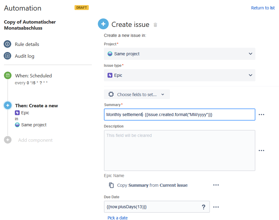

I'm using the former codebarrol app "Automation for Jira". Now I have following requirement for our monthly settlement process:
I creating scheduled tickets, which works fine. The issues are created on the last day of the month. Regarding the created date the summary should look like this:
Monthly settlemeant - mm-yyyy (from created date)
I tried to implement that with smart values, but it doesn't work. Is there any other solution for that?
I used this expression: {{issue.created.format("MM/yyyy")}}

Hi @Nicat Nagiyev ,
I think you can not get the "issue.created" value inside create issue action. Because at the time of "issue.created" function call, issue has not created yet. Instead of "issue.created", try using "now".
{{now.format("MM/yyyy")}}

Hi Nicat,
Can you share some screenshots of what you have and what is not working?
