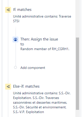

Can you please show us the entire automation rule? Often problems are caused by the context in which the step executes. We can't know the context without seeing the rule.

here the complete rule and error message

When an issue is initially created it is set to the first status in the workflow. The rule is executing after the issue creation is completed and the issues is already set to that first status.
You are getting the error that the issue can't transition to ATT_VERIF_CGRH because the issue is already in that status, and there is no transition to go from that status to that status.
You don't need to try to transition the issue to the first status as part of the rule. That is taken care of during the issue creation process. In your rule you only need to transition it to the next status - ATT_VERIF_PARH
