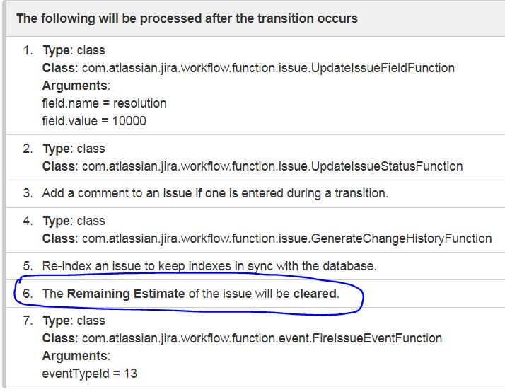

the post functions are defined like this:
Except Number 6, all the other post functions are the "standard ones" that come with the Software Simplified Workflow for Project...
We are not using any add-ons, we just created this post function manually.

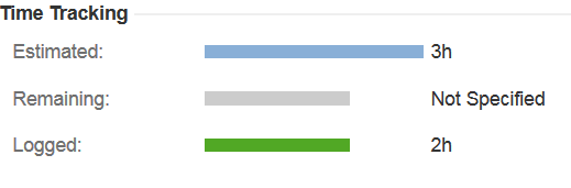

Is there a difference if you leave the field "Remainig Estimate" blank or set it to 0 when you create the function? With the empty field the Time Tracking of an item looks a bit strange, having Remaining as "Not Specified":

Thanks for the screenshots, and it looks like a post function order conflict.
You will want to move the #6 post function that clears the Remaining Estimate Field so that is is above #4 which generates the change history item.
The Report is pulling the value from the change history which has the value present at that point and then indexed with the value present but removed after these actions occur.
Also in post function logic you always want the last two Post function events to be in the order of the Reindex event then the Fire Issue Event function, this can cause odd rendering issue on the issue view and data collisions if a field is modified after the index is updated as in the current odder the index has the valued stored in the field but the data was cleared in the backend by the post function events.
Set up the post functions like this and you should be good:
