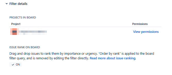

Ernest Kurmel
February 7, 2025 edited
Make sure Issue rank on board is turned "ON"
Go to: Configure board -> General -> Filter Details
If this option is turned off, then filter will not help with order rank by asc
