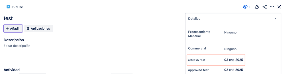

This is the search issues screen to double check: ticket (FOKI-22)
And this is the refresh test date January 3

The log is indicating that there are no issues being found that match the JQL in your trigger.
What is the complete JQL that you have used in your Scheduled trigger?
Felipe Motta January 7, 2025
This one: "refresh test" is not empty and "refresh test" >= startOfDay(1) and "refresh test" <= endOfDay(1) and status != "Done"
Trudy Claspill
January 7, 2025
You said
I want to add that based on the date (the 15 days later) that day I get an email notification
When exactly do you want to get the notification compared to the date specified in "refresh test"? Do you want to get it on that same date? Do you want to get it some number of days before that date? Do you want to get a reminder if that date is in the past?
In the example I provided I had no number in the parentheses for startOfDay() and endOfDay() which would result in the email being sent on only the same date as "refresh test"
When you use startOfDay(1) and endOfDay(1) you are telling Jira you want to compare against "start of today plus one day" (i.e. tomorrow's date) and " end of today plus one day" (i.e. tomorrow's date.
Looking at the audit log the rule ran on
4 January
5 January
6 January
The "refresh test" date in the issue you showed 3 January.
3 January is not "tomorrow" relative to any of the dates on which the rule ran.
When it ran on 4 January it would've selected issues with a "refresh test" date of 5 January.
When it ran on 5 January it would've selected issues with a "refresh test" date of 6 January.
When it ran on 6 January it would've selected issues with a "refresh test" date of 7 January.
When you specify when you want to actually receive the notification, I can offer a suggestion about how to change your JQL.
