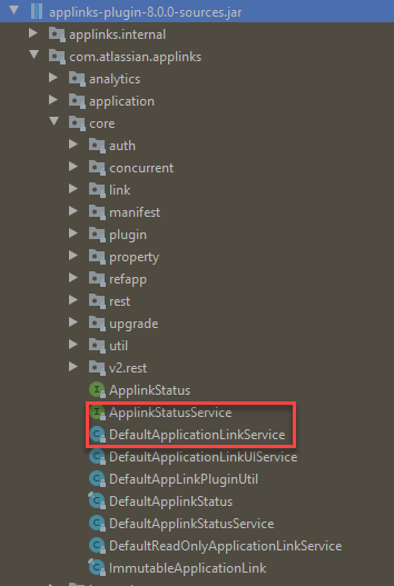

Adaptavist support only mentioned that com.atlassian.applinks.applinks-plugin have less modules (94 instead of 127) but I have jira code downloaded and DefaultApplicationLinkService is still under:
com.atlassian.applinks.core.DefaultApplicationLinkService in applinks-plugin-8.0.0-sources.jar file.
What more, Code Completions in scriptrunner works and I can see and pick methods from DefaultApplicationLinkService .

and this worked, what is the difference between DefaultApplicationLinkService and ApplinkStatusService? location is almost the same:
Any idea why this import stopped working and how properly import DefaultApplicationLinkService?

Additional question, how did you find that? I'm using Intelij and for some reason can't search text in all files in project.
Martin Bayer _MoroSystems_ s_r_o__
January 11, 2021
Hi @Łukasz Sielski priv I downloaded source of the ApplicationLink library (https://mvnrepository.com/artifact/com.atlassian.applinks/applinks-plugin/8.0.1) and I decompiled it online. So I found out the service DefaultApplicationLInkService implements MutatingApplicationLinkService. But to be honest, it is enought to check online docs:
