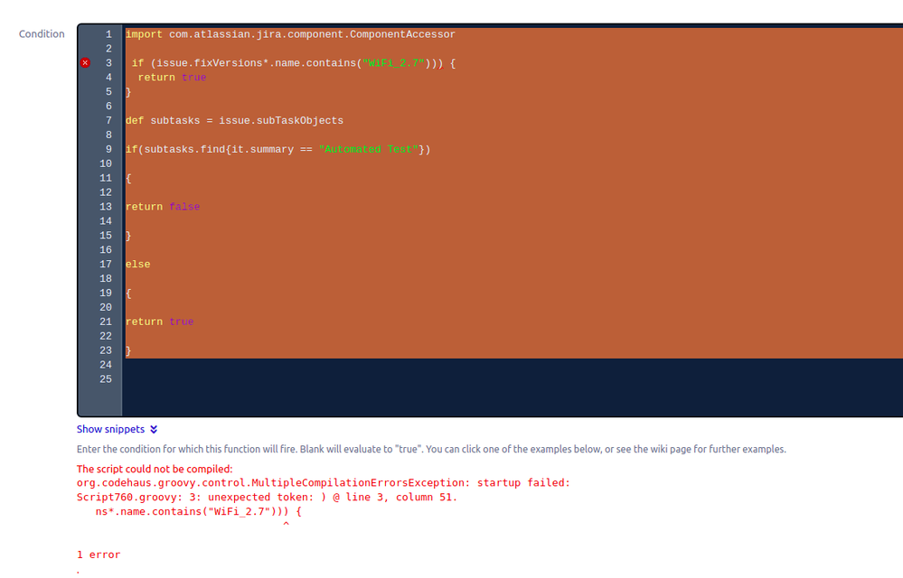

Hi @Tuncay Senturk _Snapbytes_
Thank you very much for your reply. I tried your script but it throws the error you can see the script below
if (issue.fixVersions*.name.contains("WiFi_2.7"))) {
return true
def subtasks = issue.subTaskObjects
if(subtasks.find{it.summary == "Automated Test"})
return false
else
return true
And the error logs are
The script could not be compiled:
org.codehaus.groovy.control.MultipleCompilationErrorsException: startup failed: Script760.groovy: 3: unexpected token: ) @ line 3, column 51. ns*.name.contains("WiFi_2.7"))) { ^ 1 error
Please let me know how to achieve this
