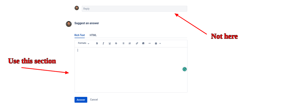

August 8, 2023
@Markus W_ BENES
You only have to use the Suggest an Answer field once, i.e. the first time. :-)
All subsequent answers you can provide in the Reply field.
Markus W_ BENES
August 8, 2023
@Ram Kumar Aravindakshan _Adaptavist_ Got it now! Thank you :D

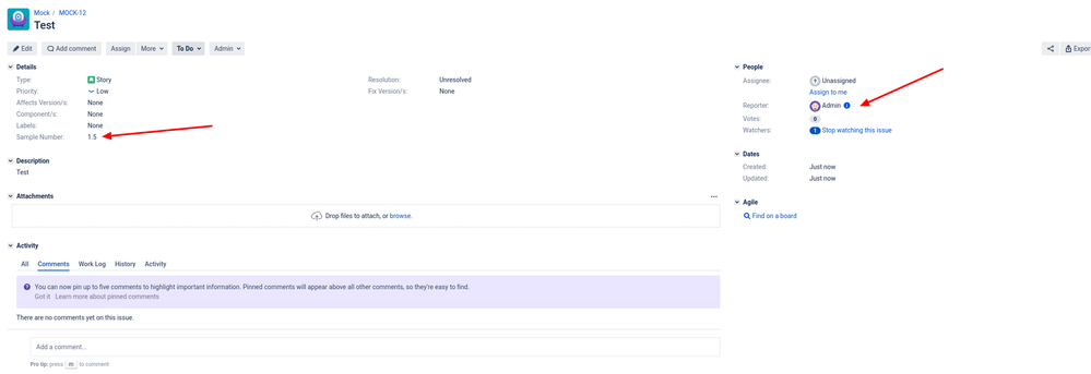

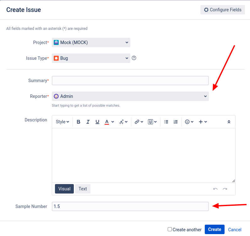

I am also including a couple of test screenshots for your reference:-
1. When a new issue is created, if the user Reporter is set to the user Admin (username is admin), the Sample Number screen is set to the value 1.5.
2. If the user is changed to Ram Kumar (username is ram), as expected, the Sample Number field is updated once again, and the value is changed to 2.5 as shown in the screenshot below:-

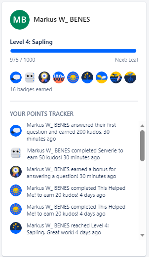

@Ram Kumar Aravindakshan _Adaptavist_ after i clicked answer was already here; after some seconds it was away again and your answer was there... looked for me like it got deleted...
my answer was definitely successfully posted because i got 200 kudos and two bageds for it.

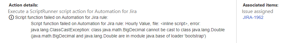

I've made an attempt to integrate your code into an automation rule, but as of now, the functionality remains elusive. The encountered error message reads as follows:
Execute a ScriptRunner script action for Automation for Jira
Script function failed on Automation for Jira rule:
Script function failed on Automation for Jira rule: Hourly Value, file: <inline script>, error: java.lang.ClassCastException: class java.lang.String cannot be cast to class java.lang.Double (java.lang.String and java.lang.Double are in module java.base of loader 'bootstrap')
Given this obstacle, I am receptive to exploring alternative suggestions you might offer to address this issue.

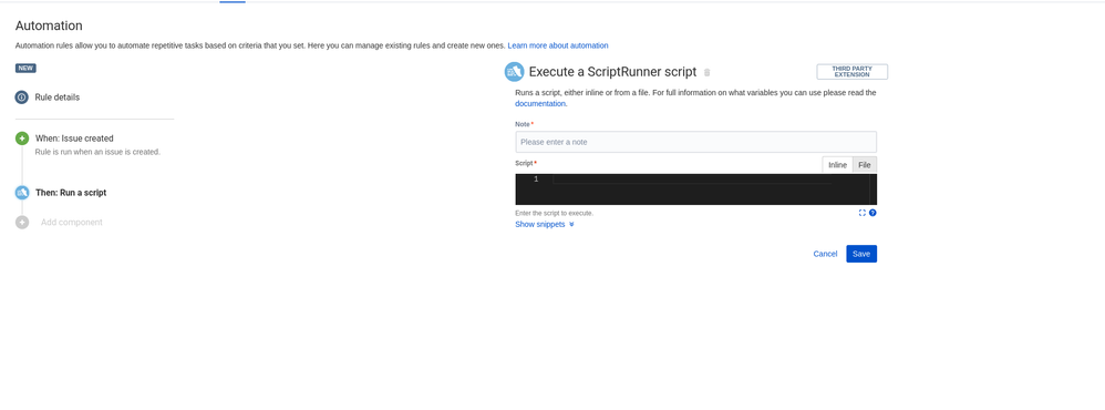

this is what I have now...
Trigger: Issue created.
Action:Run Script Runner
Code:
The example codes that I have provided are meant for ScriptRunner's Behaviour. It will not work with Automation.
This is why I have asked you for a screenshot of your automation config for example:-
This is so I can try to test it in my environment and provide a better solution for your requirement.

Running the automation, got the error:
08/08/23 12:21:30 pm (2810007)Hourly ValueSOME ERRORS0.17s
Action details:
Script function failed on Automation for Jira rule: Hourly Value, file: <inline script>, error: java.lang.ClassCastException: class java.lang.String cannot be cast to class java.lang.Double (java.lang.String and java.lang.Double are in module java.base of loader 'bootstrap').

Hi @Humberto Gomes
If you are using Automation, all you have to do for Issue Created / Issue Update is this:-
import com.atlassian.jira.event.type.EventDispatchOption
import com.atlassian.jira.issue.MutableIssue
def currentIssue = issue as MutableIssue
def reporter = currentIssue.reporter
def customFieldManager = ComponentAccessor.customFieldManager
def issueManager = ComponentAccessor.issueManager
def sampleNumber = customFieldManager.getCustomFieldObjectsByName('Sample Number').first()
if (reporter.emailAddress == 'user1@mail.com') {
currentIssue.setCustomFieldValue(sampleNumber, Double.parseDouble('1.5'))
} else if (reporter.emailAddress == 'user2@mail.com') {
currentIssue.setCustomFieldValue(sampleNumber, Double.parseDouble('2.5'))
issueManager.updateIssue(currentUser, currentIssue, EventDispatchOption.DO_NOT_DISPATCH, false)
Below is a screenshot of the Automation configuration:-
I have tested this code, and it is working in my environment.
Below is a test screenshot for your reference:-
I hope this helps to solve your question. :-)

August 8, 2023 edited
@Markus W_ BENES
A minor suggestion. When you have a solution to suggest, it would be best to add it using Suggest an Answer for the first time instead of the reply so it is easier to identify your solution.

Humberto Gomes
August 8, 2023
@Markus W_ BENES
No, is not working.
ScreenHunter 1721.png ScreenHunter 1722.png ScreenHunter 1719.png ScreenHunter 1720.png

As I indicated at the outset, this merely constitutes the initial phase of a substantial project in progress...
final script: (used in a automation triggered once the ticket is created)
