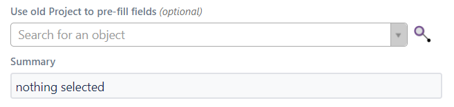

Nothing selected so far so okay ->

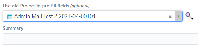

Project select ... Not so okay... ->

Dirk Ronsmans
May 5, 2021
Hey @Marcel Kroner and welcome to the community!
I'm wondering if this is causing you issues:
getFieldById("Use old Project to pre-fill fields")
you use the getFieldById but then use the name of the field.
Could you try with either getFieldByname("") or input the customfield_xxxx ?
Marcel Kroner
May 11, 2021
Hello Dirk,
thank you very much! I never thought I would get such a quick response as I got from you :)! Thank you very much!
Your answer is partially correct.
getFieldByName("") returned me the insight object, but not the string inside the field.
I can work with it, but people looking for the string value would not be helped by it, I think.
