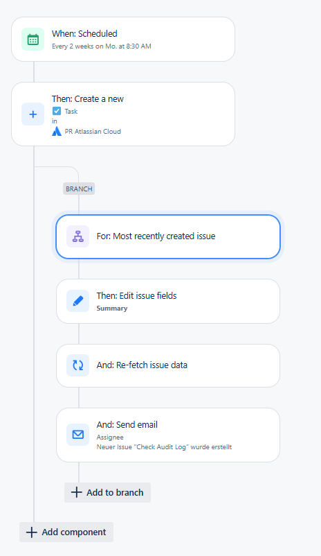

The automation is set up like:
- trigger every two weeks
- creat new Task Issue
- send notification to assignee
But the Audit Log shows an error at the last step sending the notification mail, as no issue is present so it can not get the assignee. BUT the issue has been created correctly
Why isn't it getting the just created issue and assignee of it?

The solution looks like this:
Hi @Martin Flury , try adding a re-fetch data action before sending the email? This often times fix similar issues where there is a race condition.
I implemented the solution from Bill, which solved my missing email problem.
After adding the "Edit issue fields" action your solution helped me adding this new values to my new email in the step afterwards.
So thank you very much for your help as well.
Your rule image shows using the Assignee for the Send Email action, but there is no issue within scope at that point in the rule.
The fix is to add a branch to most-recently-created-issue before the email action:
Another way to solve this would be to use the smart value for the email address rather than selecting Assignee from the dropdown in the To field: {{createdIssue.assignee.emailAddress}}
@Bill Sheboy you nailed it.
Adding the branch did solve my missing email problem.
After that I got every mail.
Thanks again for your help. Appreciate it.

You are most probably not using smart values in the right way.
Can you share the screen shot of what you have in email form?
I have to admit I'm a greenhorn in Jira automation and the usage of smart values is definitely not one of my strengths.
In this case the adding of a branch solved my original problem and my secondly created problem, having access to the edited field values for the mail, got solved with the re-fetch.
