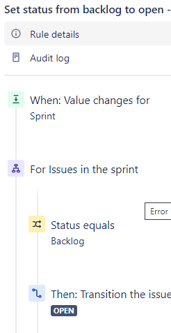

For this I have created the rules and which are working fine.(Attached rules above)
Now I would like to make it as a global rule, which is not possible because we do not have option to select multiple boards.
when a sprint is started, every issue inside is set from backlog to open
the rule is also including events when the issue is moving from one sprint to another or from one sprint to the backlog
Set an active sprint from "Backlog "to open
1. The start sprint filter is considering boards in "XYZ" project ONLY. it should be generic capturing any sprint under any project or board.
2. The project filter should be only in the "SCOPE" of the rule. But right now I am also using the project "XYZ" in one of the components of the rule.
this should be removed.

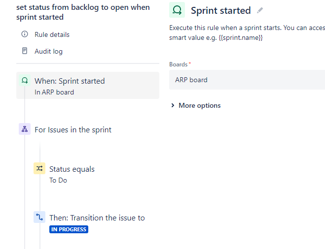

As per your previous suggestion I have gone through document,
"Set status from backlog to open " As per my understanding The automation rule vary through Workflow.
The above mentioned diagram ,For that workflow is (Todo, inprogress,Done)
Now I would like to create for one more project ,Workflow is ( backlog,open ,inprogress,close)
I have changed the rule by replacing status ,Which is not working.
Please find the image and suggest necessary changes
Just to confirm did you recreate the rule in the other project, or change the rule to be global/multi-project in scope?
That is important if one of the projects is team-managed, as they have separate instances of status values for each project...even though they may have the same status names.
