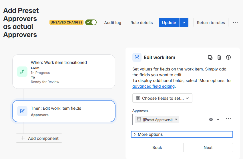

My idea was to create a custom multi-user field (let’s say “Preset Approvers”) which is available from start on to and create an automation that copies the content of this to the approval field, as soon as the transition that triggers the approval happens.

This is what I tried:
In the audit log it shows it run succesfully, but the users aren't added as approvers.
For the smart value I tried
{{Preset Approvers.accountId}}
{{Preset Approvers}}
{{Preset Approvers.displayName}}
{{Preset Approvers.key}}
without success.

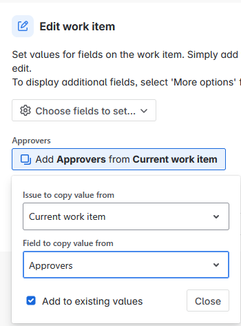

Try doing a copy from that field. Click the 3 dots beside the Approvers field and select Copy. Then select the name of the field.

I'm not super experienced with automation, but I've certainly been looking into it recently. It's only thanks to your comment that I understand how to use this copy function. ^^ You have to click again on "Add XYZ from current work item" after selecting Copy to get to the options for selecting the source 🤯😁

Unfortunately, the selection of fields from which I can copy does not show my (custom) field "Preset Approvers":

So when you click on the dropdown for Approvers, you don't see your custom field there? Exactly what type of field is your custom field?

Exactly.
The field is type "People"
