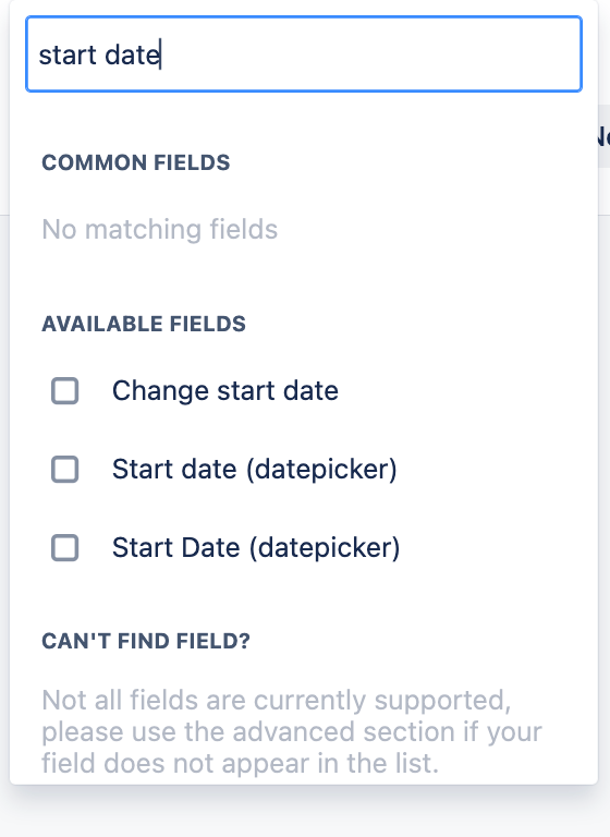

I want to make an automation rule that will work under the following conditions:
TRIGGER: Issue created
THEN: Edit issue field - Start date - Copy from current issue Created
But when I search for the "Start date" field in the list of available fields, I can't find it. There are only custom fields.
For example, I can find system "due date" field, but there is no system "start date" field.

Though it might not be labeled as such, the Start date field (lowercase d) is the one added by the system.

The system field was not detected.
I tried to use the ones I found - none of them worked.

Hi!
Founded that locked field in the list of the custom fields.
But still cant see it in the list in my rule.
Игорь Титов
August 19, 2024
