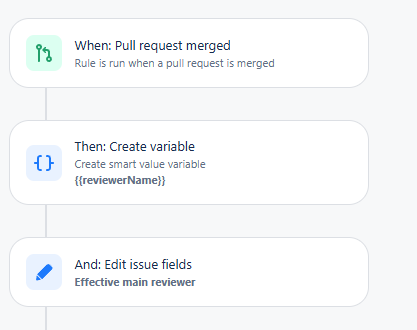

I have been checking the documentation associated with smart values ​​for Pull Requests - https://support.atlassian.com/cloud-automation/docs/jira-smart-values-development/#--Pull-request-- however I can't find any associated smart value that could give us the information associated with the reviewers of that same Pull Request.
My goal was to create an automation as simple as, when a pull request was merged then collect the name of the reviewer(s) and fill in a field of the associated issue with that same name(s). Attached is the automation.
Can someone help me?

Hi @Cláudia Silva
Are you using BitBucket?  If so, the REST API does not support that information, and here is a suggestion to add it: https://jira.atlassian.com/browse/BCLOUD-22700

Hi @Bill Sheboy ,
Yes, I'm using Bitbucket. The option is to collect via API by Bitbucket this information in this case...

Hi @Cláudia Silva
If its not listed, then it doesn't exist as a smart value
