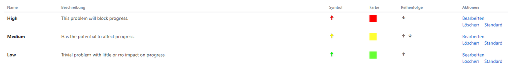

Hello everyone,
i already checked the Posts about this topic below, but these didnt help for my Problem:
I want to sort my Backlog by Priority.
I created 3 types, as you can see at the picture below:
Project = "Projectname" ORDER BY priority DESC
But when I activate this Filter, it is simply not working!
Thanks 4 your help

Philipp Goennenwein
September 17, 2018
Thats crazy,... mine isnt.
As you can see, my Backlog isnt ordered by prio.
My Filter (Sort by Prio) is set, but it does simply not order my Backlog.
