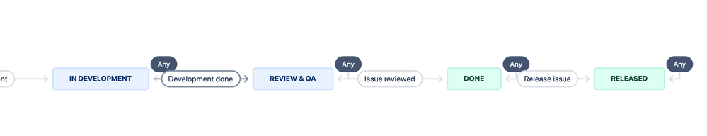

Reading through the forum, I've found that the reason for this is because the issues that are done are not set to the utmost-right column on the board. Our workflow is currently as follows on the board:
To do > In development > Review QA > Done > Released.
We like to save up features before releasing them, but this will prevent the sprint reports from generating any useful data.
Could anyone advise me how to handle this better in Jira? A way that will ensure we get value out of the reports and are actually able to calculate our velocity, without losing track of what's currently released to the public and what's not?

Hi @tim-vandijck
As you noted in your original question, Jira Scrum boards detect completed work in a sprint (for burn charts and other reporting) when the issue is in a status mapped to the rightmost column on the board.
Your team appears to track releases separate from the sprint work...and you note using a Team-managed project.
You could do that using versions (with the Fix Version field) and release when needed, rather than having a separate status value.

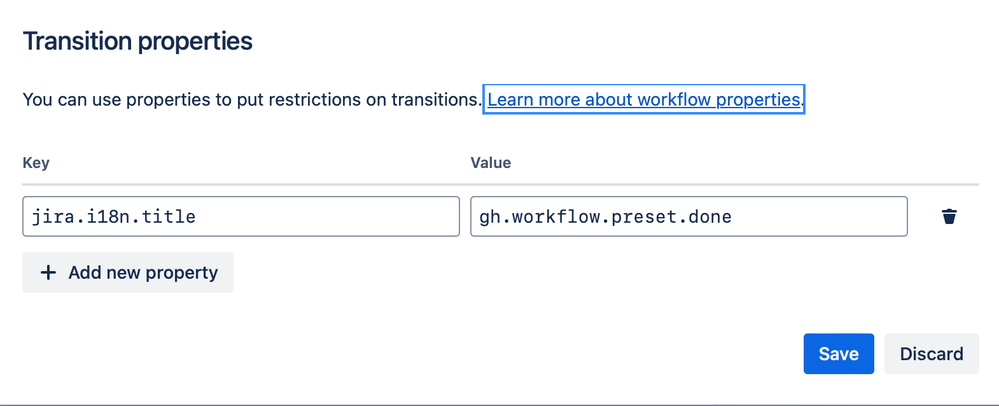

That's useful info. Can you try this?
Edit the workflow, go to the transition coming into the Released stats and add a workflow property below.
tim-vandijck July 25, 2024
I've done as you indicated, what would this do?
Anandhi Arumugam _Cprime_
July 25, 2024
yes, that should work.
I'm afraid it's not changing anything in the reports. Still no completed work this sprint (whilst 1 issue is currently done)

The issue should be in Released status to be able to show up on the reports.
