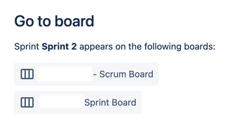

If I click on Sprint 2 from Ticket X, I get this page:
There's a possibility we're running into this problem again where sprints aren't sourced from the board we thought, but I don't think so because it shows as existing on two different boards.

Correct, if you delete the sprints that will affect both teams. Yes, you could redo the filter, but that only fixes the stats, not the underlying issue. Yes, if you move the ticket over to project A it should remove the sprints from project B.
You could very well run into this issue again, it usually happens when a user assigns the sprint from within the work item detailed view, and not paying attention to which sprint is selected. I always recommend assigning the sprint from the backlog, that is the easiest way to avoid this.
Note that sprints are not board/project specific, and before Atlassian added a checkbox to only show sprints created in the current project when assigning it in the detailed view, this was very common.

1. Sprints are not limited to containing issues from the board in which the sprint was created. Any issue can be added to any sprint, if you have sufficient permissions.
2. An issue will retain the history of sprints it was in that were completed with the issue still in the sprint, regardless of whether the issue is moved to another project.
3. An issue can be in only one Active or one Planned sprint at a time.
Because of 2, when you moved the issues to another project they took their sprint history with them.
Because of 1 and 3 a scrum board will display any Active or Planned sprint to which an issue has been assigned for any issue within the board's filter scope. That way when you are in a board and want to add a given issue to a sprint, you can see that it is already in another active or planned sprint in another scrum board.
Also because of 1, 2, and 3, when you look at the reports for the scrum board you will see all the sprints (completed and active) that are associated to the issues within that board's filter scope.
If you move the issues back to the original project the sprints will no longer show in Project B's board. But the issues also will not show up on Project B's board because they would no longer be within the scope of that board's filter.
