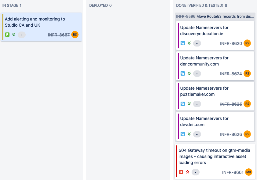

I had the same issue - Board not showing Story Points in the grey bubble. Showing Estimated Hours (which we were originally tracking against). Whilst, I was able to add Story Points to the bottom of each card as one of the 3 extra fields (via Board config > Card Layout) but that just showed as a number, no label.
To stop the grey bubble showing Time and show Story Points, I had to change the Board Config > Estimation > Time Tracking value from 'Remaining Estimate and Time Spent' to 'None' (note: Estimation Statistic was already set to 'Story Points').
Once I did that, grey bubble on board shows Story Points value.

In the case where you're not seeing the points on the board, but there's an empty grey box where it should be, AND you know you have set story points, for some reason there are TWO story points fields. "Story Point Estimate" is for next-gen projects. "Story Points" is for classic. I suspect you've set your story points in one of the fields, and the board is showing the other field.

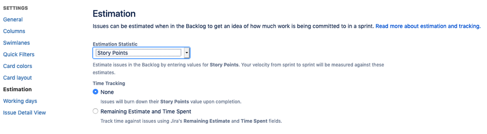

Tuncay Senturk _Snapbytes_
May 7, 2018
Hello Ben,
Go to board configuration and click on Estimation tab.
Make sure that "Story Points" is selected under Estimation Sttistics
Ben Nowacky
May 7, 2018
Thanks, but already did that. The results in the screenshot is with estimations = story points already applied.

Just faced the same issue but I figured it out! here's what I did to resolve the issue for my team:
  1. Select Board Settings > Estimation
  2. Make sure you have Time Tracking set to 'None'
The story points should appear in the Sprint Board again on the issue cards.
Happy building, hope I helped
