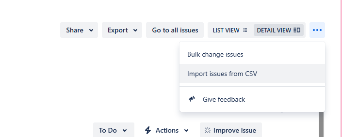

One more detail:
When I try the to perform the upload from the issue view, I get this error: issue view.png key cannot be a subtask.png
Do I need to rearrange the order of the columns?
