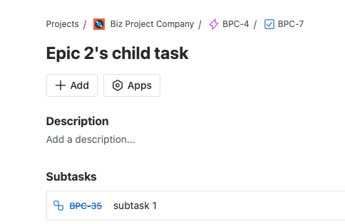

I see the strikethrough on the issue key for Done issues only when looking at the Child Issues/Subtasks display within a parent issue. And only for issues where the Resolution field is set.
Screenshot 2025-01-23 at 9.25.23 AM.png Screenshot 2025-01-23 at 9.25.12 AM.png
I don't see strikethrough in the cards on the Board view nor in the List view.
