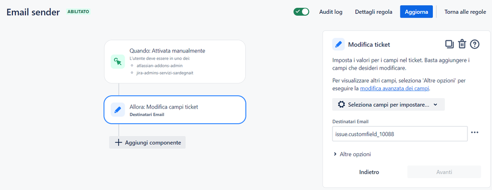

I need to copy the value of a custom field in another custom field. I am using jira automation. The trigger is manual, I tried a lot of ways:
or in the "other" configuration putting this simple json:
"fields": {"customfield_10034": "customfield_10088"
but the automation fail with an error "Campi sconosciuti impostati durante la modifica. Questi campi potrebbero non essere disponibili per il progetto/tipo. Verifica la configurazione dei tuoi campi personalizzati. Campi ignorati -

Hi @Chiara Squilloni , ok, thanks.
https://support.atlassian.com/cloud-automation/docs/jira-smart-values-issues/
In the destinari email field, have you tried including the curly brackets-
{{issue.customfield_10088}}
^ like this?

Hi Valerie,
I try also this
but doesn't work.

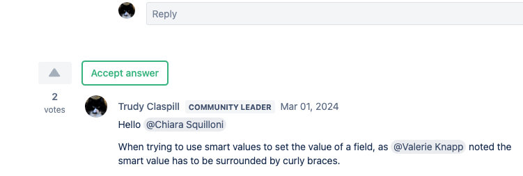

Hello @Chiara Squilloni
When trying to use smart values to set the value of a field, as @Valerie Knapp noted the smart value has to be surrounded by curly braces.
Additionally, depending on the types of these fields you may need to use a different smart value reference.

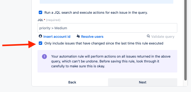

Regarding your last question about having changed to a Scheduled trigger and no actions getting executed:
Check the details of the trigger configuration. Do you have this box checked or unchecked?

Hi dear @Trudy Claspill and @Valerie Knapp I have an update but I still have a problem.
I was triyng this automation on my sandbox and maybe there's something I didn't set about persmissions, also if I migrate the project from the production enviorment.
So I try in production environment and all works... but know I change the trigger, because I need to act on a set of issue that I find by a jquery.
So I change the trigger from manual to scheduled and I put the jquery that find more than 2000 issue, but wen I do "execute rule" or wait for the execution I find "no issue affected"... why?
Could it be this issue that @Trudy Claspill mentioned -
You could have a JQL search that returns a number of issues but if they haven't been updated, the automation wouldn't run.
