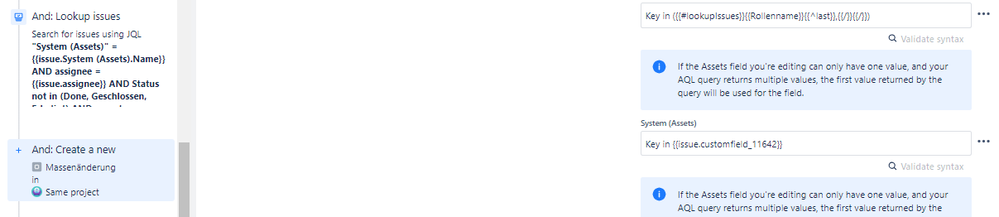

As mentioned, I simplified the automation in my comment. The real query in the lookup is:
"System (Assets)" = {{issue.System (Assets).Name}} AND assignee = {{issue.assignee}} AND Status not in (Done, Geschlossen, Erledigt) AND reporter = {{issue.reporter}} AND issuetype != Massenänderung
Now I am accessing the field "Rollenname" in every found issue to populate a multivalue asset field while creating a new ticket.
Key in ({{#lookupIssues}}{{Rollenname}}{{^last}},{{/}}{{/}})
After creating this new issue, I want to update the found issues in the lookup. To iterate over them, I am using the same query.
