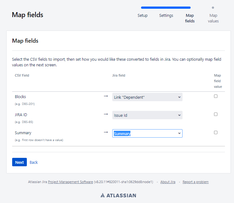

Leo Acosta October 20, 2022
It's basically three fields and I tried a variety of permutations:
  • Summary (left blank and populated with the existing issue summary)
  • Issue ID
  • Blocker ID
I tried swapping the Issue ID and Blocker ID; I also tried using different Link Types (Blocks vs. Dependency etc) with poor results.
If I leave Summary blank (which has worked in the past and is documented in the instructions) I get an error that the issue can not be created or I get a message that says at least one issue not found (both issues are in my project).  If I populate the Summary with data, the import ends up creating a new issue.
I just want to update links through the import tool on existing JIRA issues.  Has me pulling my hair out.
"Issue Key" is not an available field in my instance.  I was using "Issue ID"

You need to change the Jira ID to Issue Key.  Issue ID is a system generated ID and will always assume a new issue being created.

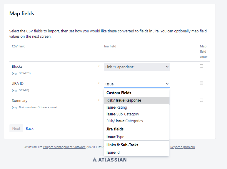

Leo Acosta October 20, 2022 edited
Issue Key is not an available option in the import map.  Could it be a permissions issue?
Mark Segall
October 20, 2022
It may just be Key.  Sorry, it's been a while since I did my last import.
Don't be sorry.  I really appreciate you trying to help.  There is no field exposed with the word "Key" in it anywhere in the mapping screen.
