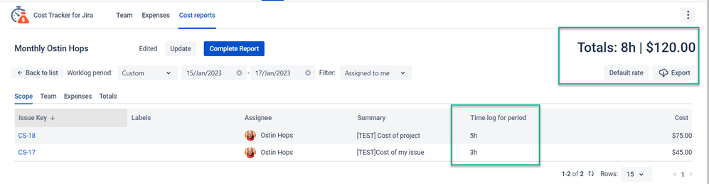

Iryna Komarnitska_SaaSJet_
January 19, 2023
Hi @Caio Covos
Try to use add-on , developed by my team - Cost Tracker for Jira Cloud .
It multiple People logs to People rates per hour, and you can generate reports with this data. Also, the Cost Tracker for Jira Cloud add-on allows you to track all your company's expenses.
It's free.
Example of report:
