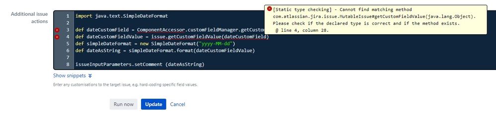

Hi, @Martin Bayer _MoroSystems_ s_r_o__ , Now I have other errors:
I am barely aware of "groovy", sorry for the inconvenience.

Hi @Prueba Cliente Edu you just need to add another import
It will solve first error. The other error is only static type check of groovy and it will work without resolving it.
The issue here is that Groovy does not use object types as strictly as Java do...

I have already modified it, but I have another error when executing:
2021-04-08 11:38:36,262 ERROR [jobs.EscalationService]: Escalation Service (Prueba Escalada) failed for issue BBVA-10
groovy.lang.MissingPropertyException: No such property: created for class: Script25
at Script25.run(Script25.groovy:4)
My groovy code that I am running is this:
import java.text.SimpleDateFormat
def dateCustomField = ComponentAccessor.customFieldManager.getCustomFieldObjectByName(created)
def dateCustomFieldValue = issue.getCustomFieldValue(dateCustomField)
def simpleDateFormat = new SimpleDateFormat("yyyy-MM-dd")
def dateAsString = simpleDateFormat.format(dateCustomFieldValue)
issueInputParameters.setComment (dateAsString)
Can you help me, please?

Yeah, your code
is wrong. You need to set custom fields name as the parameter of the method getCustomFieldObjectByName. It should be something like
 def dateCustomField = ComponentAccessor.customFieldManager.getCustomFieldObjectByName("Name of my field")
