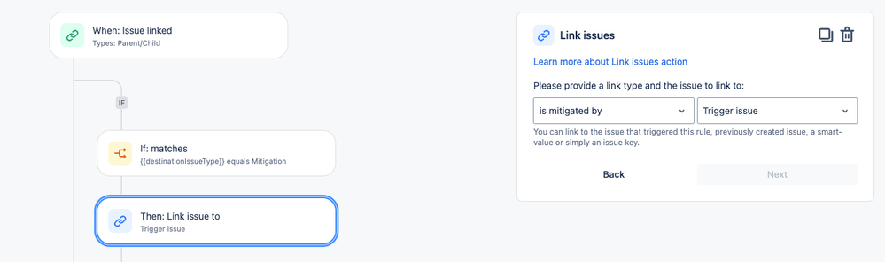

The long and short of it is that we have an app that tracks (for example), how many risks are linked to a risk category and displays links to those risks.  It counts based on the type of link.  I want to make an automation that will automatically apply a certain type of link to an issue when it's made a child of an epic, depending on what type of issue it is.
Lana Kelly
April 11, 2024
This is what I have so far, but the {{destinationIssueType}} isn't the right key, I don't think.

Hi @Lana Kelly, no indeed it isn't 😅 - if you insist on using smart values instead of the approach I shared in the screenshot above, try:
{{destinationIssue.issueType.name}}
to refer to the issue type.
Lana Kelly
April 12, 2024
Hello @Walter Buggenhout I tried your approach, and it works, but we didn't have the parent field in this issue type, because we wanted to call it "risk category" and just use the linking function.  I was just wondering how it would be done if we did it that way.  Thanks for your help.
