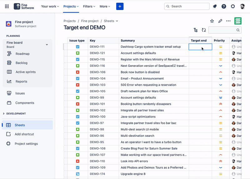

if you're open to solutions from the Atlassian Marketplace, you may want to try out JXL for Jira. It's a full-fledged list/spreadsheet view for your issues that allows viewing and inline-editing all issue fields, of course including the Target end field.
JXL integrates into your project sidebar (as "Sheets"), so it could be a good alternative to the project list view.
Here's how it looks in action:
It's worth noting that JXL can do much more than that - e.g., it supports issue hierarchies, inline issue creation, export to various data formats, and much more. More info at https://jxl.app. (Disclaimer: I work on JXL :))
