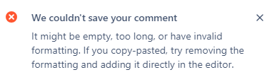

I am trying to drop 16 lines of javascript in a ticket. I get the same error if I add to description or comments. Is there a workaround? Its much better for my developers to add code directly to a ticket without using attachment.

Hi @Ian Wagner,
how many characters are in the code snippet? Jira Cloud seems to have a limit of 32767 characters in a text field.
There is currently no solution until Atlassian adds on option to control the limit: https://jira.atlassian.com/browse/JRACLOUD-64351.
Roman.
Ian Wagner February 3, 2019
@roman
646 characters
roman
February 4, 2019
Thanks for the info, Ian.
I have tried to add a code macro to the issue’s description with 687 characters across 16 lines. It worked for me without problems.
Can you try adding the code just as plain text to the Comment or Description field?
Roman.
Ian Wagner February 4, 2019
Yes - I can add to Comment and Description as plain text. However, I want to add as code block to keep the formatting in line with the code.
roman
February 4, 2019
Would it be possible to share the code of the macro and the contents in wiki markup? I will try to add the same to my Jira.
Roman.
Ian Wagner February 13, 2019
I have to switch to Old View, drop the code and save.
This works but it appears that New View has an issue. At least for me
roman
February 14, 2019
Great the we have a workaround!
I hope Atlassian is aware of this.
Roman.
