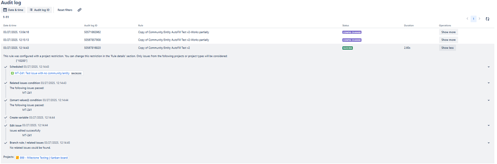

Ganea, Merissa March 27, 2025
Audit Logs: Audit Logs.png
Trudy Claspill
March 27, 2025
Thank you for that additional information.
So you are trying to copy data from field "Community/Entity" in the parent issue to the exact same field in the child issue. The field is a Select List (cascading), and its ID is 10031.
The bit about merging and copying the data to a field confused me.
