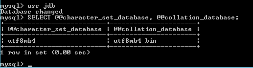

@Nic Brough -Adaptavist- I created my new database like this:
CREATE DATABASE <dbname> CHARACTER SET utf8mb4 COLLATE utf8mb4_bin
and then I used mysqldump to transfer the old database to the new one.
Here's the screenshot:
As you can see everything is set correctly.
I assumed you did, but we need to find out why your database is telling Jira that it is utf8 rather than utf8mb4. Are you sure Jira is looking at the right database?
Yes. I'm sure. Here are the screenshots of Jira Configuration Tool and dbconfig.xml file:
