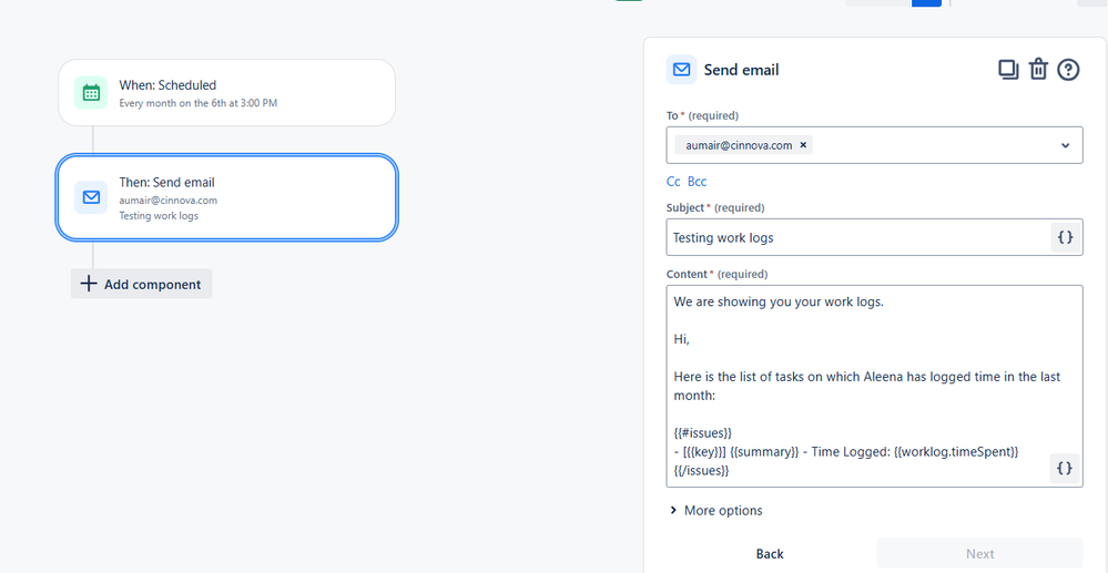

I am working on a task, I want Jira to send an automated email at the start of month to the user.
The email should contain all the issues that user has logged work on, I used this query
worklogDate >= startOfMonth(-1) AND worklogDate <= endOfMonth(-1)
and following email body:
{{#issues}} - [{{key}}] {{summary}} - Time Logged: {{worklog.timeSpent}} {{/issues}}
but with this, I am getting multiple emails for each issue, I want to include all issues in one email, where I am wrong here?

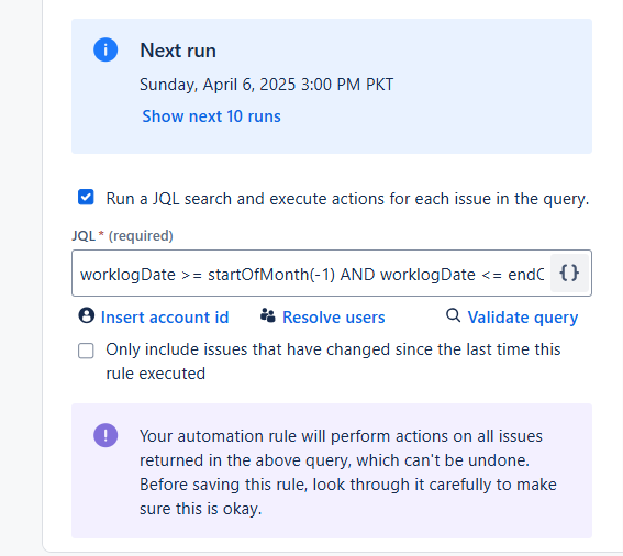

Hi @Aleena Umaiir ,

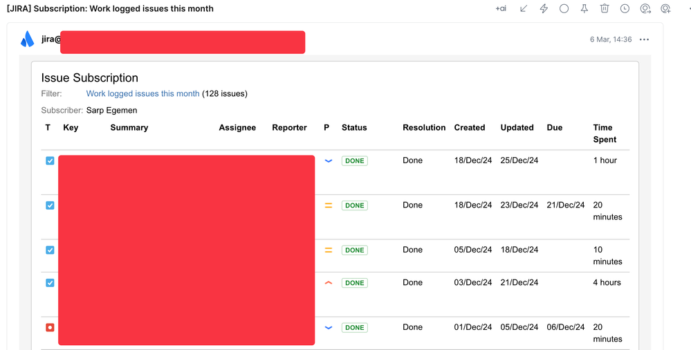

As the warning in your screenshots also states, the action will be executed for each issue matching the JQL. That's why you receive an email for each matching issue.
You can still use automations, but I believe what you are trying to achieve is already a feature of Jira called "Filter Subscriptions." You can save any filter and then subscribe a group (or user) to receive those issues in a periodically timed email, similar to the format you mentioned.
Here you can find more about filter subscriptions: link
Here is an example how a filter sub. looks like as an email:

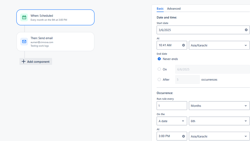

Can you share the screenshot of your automation to better understand where the issue could be?
Aleena Umaiir
March 6, 2025
Aleena Umaiir
March 6, 2025
@Vishal Biyani  here you go, please look into it
Vishal Biyani
March 6, 2025
Can you describe your problem in some more detail?
As per the SS, automation will trigger at scheduled time and send one email.
it doesn't look like this will send multiple emails.

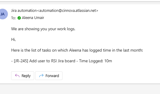

Aleena Umaiir
March 6, 2025
I am receiving multiple emails, each email has one issue,
I want all issues to be placed in one email, below is the ss of the one of the multiple emails I received4.PNG
Vishal Biyani
March 6, 2025 edited
in that case take out the JQL from Scheduler.
After Scheduler add an action lookup with the JQL that is currently inside scheduler.
Then in the email iterate over lookupIssues.
This should resolve the problem in my opinion.
This is how the automation will look like
The email body should have something like this:
{{#lookupIssues}} - [{{key}}] {{summary}} - Time Logged: {{worklog.timeSpent}} {{/}}
Let me know how it goes for you
Aleena Umaiir
March 6, 2025
Thanks @Vishal Biyani it worked.
