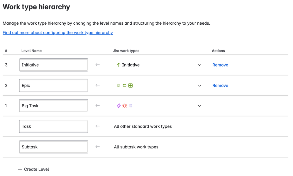

Staffan Redelius
July 15, 2025
Hi @Derek Habington
Have you checked out the info @Brita Moorus added? I think that explains it very well. You will need to rename the Epic level to New Feature and add Epic as the new level above New feature
This is the standard setup:
Epic (level 1)
Story (level 0)
Sub-Task (level -1)
Your setup after changes:
Epic (level 2)
New Feature
(level 1)
Story (level 0)
Sub-Task (level -1)
Does it make sense?
Like # people like this
Brita Moorus
July 15, 2025
Hi, @Derek Habington! 👋
To add to what @Staffan Redelius said, if you're on Jira Premium plan and admin, you can navigate to Jira settings > Work type hierarchy and change the settings from there. But it's a good idea to test it out in a sandbox environment because it'll affect all company-managed projects.
You can read more from here: https://support.atlassian.com/jira-cloud-administration/docs/configure-the-issue-type-hierarchy/
Hope this helps! ✨
