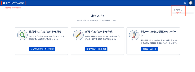

Wang, Lan 1 April 16, 2020 edited
Thanks for your quick response. It does not work for me.
When I login as the administrator, there seems only logout option for me, as is shown in the attached screenshot.
I really need your help

I'm not sure since your screenshot show japanese characters but I think this is the first screen after installing Jira, you just need to click on the first button on the left and this welcome screen will disappear. You will then have access to the Settings button.

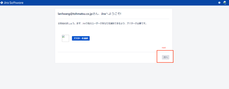

first, When I log in the site as admin, I am asked to select language.screenshot 20.png
Even after selecting English, and hit 「Continue」, still comes with Japanese(a little wired), asking select an icon. I goto next
Then comes the welcome page. I tried to click on the icon on the left top. but there's no reaction. All I can do is create a new project or logout. I can successfully logout. the login user is the admin. But I cannot create a new project successfully. Please help me out.

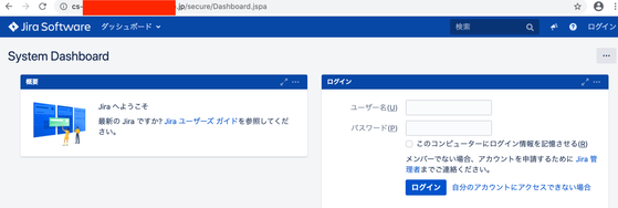

if I remove the "welcome.action" and hit enter key, it goes to the following screen.
After log in as admin, it goes to the language selection screen of my last post.
What happens with my admin user, it seems that my admin user does not have any privileges.
