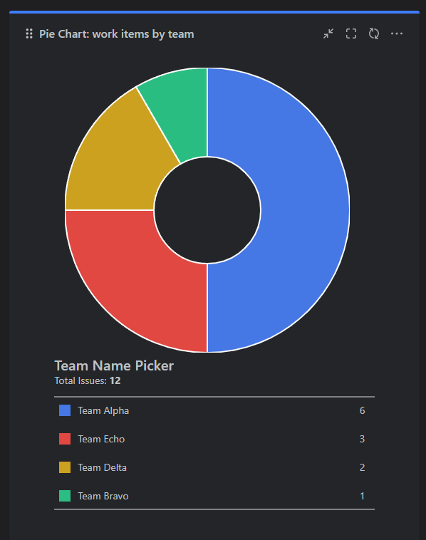

Hey Jeroen, is this about what you're looking for? The chart is built on a single select custom field that is synced via automation with the actual team field from the work items. When the team is changed, so is the custom field and the chart is updated as well. teamPie.jpg.png
Like jeroen_wilmes likes this
jeroen_wilmes
May 5, 2025
Hi Jordan, that is exactly what I'm looking for.  Wonder how you made the automation rule, because that is where I got stuck.
Jordan Dowdy
May 5, 2025
Hey Jeroen, the rule just listens for changes in the default Team field and then sets the picker field with a smart value like I showed previously. You want the options to exactly match the team names, then just use the set field value component with a smart value such as {{issue.customfield_10001.name}}. In this case the customfield_10001 is the actual “Team” field. You can verify what the field is in your instance with the Jira issue API.
