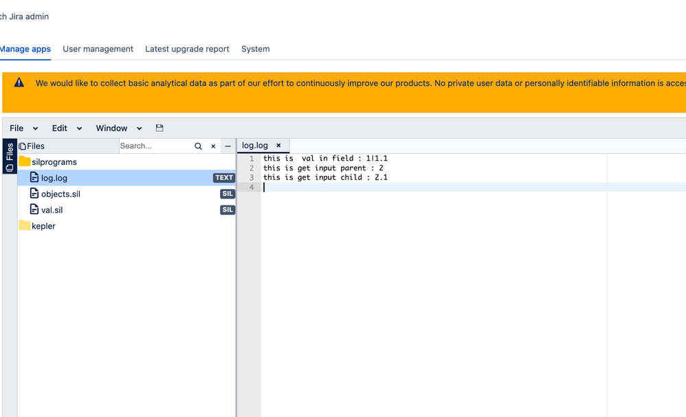

HI @Jay Keck @Vijaya Pazhamalai ,
I could see the cascading field working on my side as expected.
Can you please raise a support ticket with so we can work with you to find the issue you are facing? https://marketplace.atlassian.com/apps/43318/power-scripts-jira-workflow-automation?tab=support&hosting=datacenter
here I am sharing the screen capture showing the value that the getInput captures.
Screenshot 2024-05-10 at 7.50.57 PM.png Screenshot 2024-05-10 at 7.51.22 PM.png Screenshot 2024-05-10 at 7.51.35 PM.png
