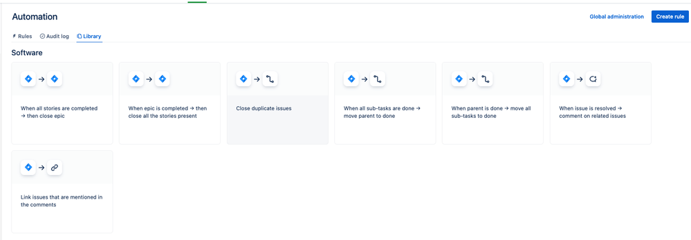

This is already created in the Automation library, if you go to the Project Settings and then click on Library:

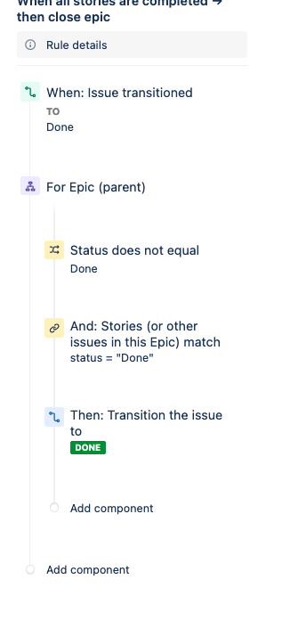

You'll see an option for When all stories are completed -> then close epic.  See the screenshot below if you need to create it from scratch.
