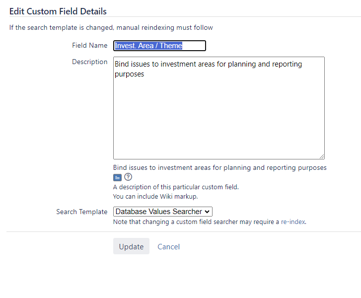

Here is a screenshot of the custom field configuration "Invest. Area/Theme"
September 25, 2023
Hi @Mouna Hammoudi
I can confirm that the field you are using is not from ScriptRunner. Instead, it is from another third-party plugin called Database Values for Jira.
Jira no longer supports this plugin as it is only compatible with Server instances and not even DC.
I suggest you change the approach you are currently using, i.e. do not use the Database Value for Java's Database Values Searcher field.
Instead, use ScriptRunner's Database Picker or convert a Single Line Text Field into a Single Select or Multi Select field, depending on your requirement.
Thank you and Kind regards,
Ram
