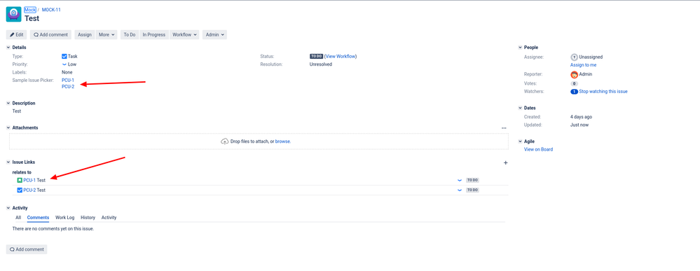

There is multiple issue picker field on screen where I select multiple issues. I need those selected issue to be available in Issue Links.
How can I write listener for this on issue creation and issue update event?

Below are few test print screens:-
1) When the issue is being created, two linked issues are added as shown below:-
2) Once the issue is created, the Issue Link is automatically created as shown below:-
3) Similarly, if an issue has already been created, and the links are included as shown below:-
The issue link will also be created as shown below:-

But the thing is I want linking should be done from both the sides like as MOCK-6 is showing PCU-8 and PCU-3 in Issue Links same should be done from PSU-6 side need to show MOCK-6 in Issue Links
Hi @RSP ,
When a link is created from one issue to another, the issues involved in the link will automatically have the link.
When the link was created in MOCK-6 to PCU-3 and PCU-8, the link was created in MOCK-6 as well as in PCU-3 and PCU-8.
There is no need to do an additional linking config.
Below are the print screens for your reference:-
I hope this helps to answer your question. :)
Thank you and Kind Regards,
Ram
